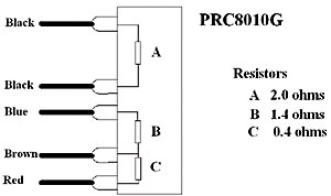

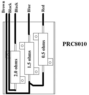

I just received the new Atlantic British PRC8010 Heater Blower Motor Resistor.
Since I couldn't access the stock wire harness plug without removing the top of the dash, needed to splice the wires from the stock harness to the new one.
As you can see the wire colors on the stock RRC harness are not the colors listed in the diagram.
I assumed that the wires from the new resistor go to the original wire harness as such based on the spacing of the coils.
Yes it works, I now have a 3 speed fan .
A - BLACK to Grey w/Red Band
- BLACK to Red w/Grey Band
B - BLUE to White w/Black Band
- BROWN to Yellow w/Black Band
C - RED to Red w/Black Band
Old PRC8010G
New PRC8010
