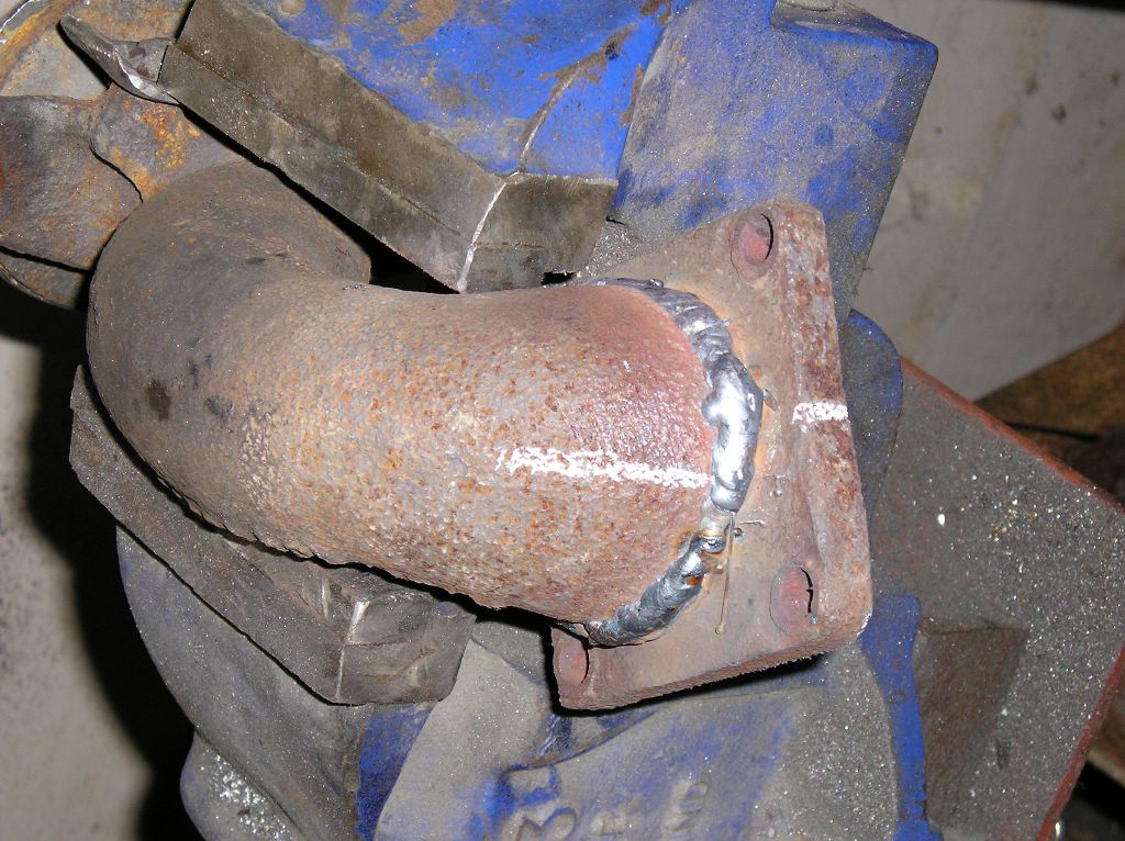

The turbo output pipe that come on the Peugeot interferes with just about everything, the firewall, the engine crossmember and the front driveshaft. One had to be fabricated. First I located a unit off a late 90s VW turbo diesel which exits directly do...
The turbo output pipe that come on the Peugeot interferes with just about everything, the firewall, the engine crossmember and the front driveshaft. One had to be fabricated. First I located a unit off a late 90s VW turbo diesel which exits directly downward. It had to be cut and rewelded about 10° so it would not hit the firewall.
