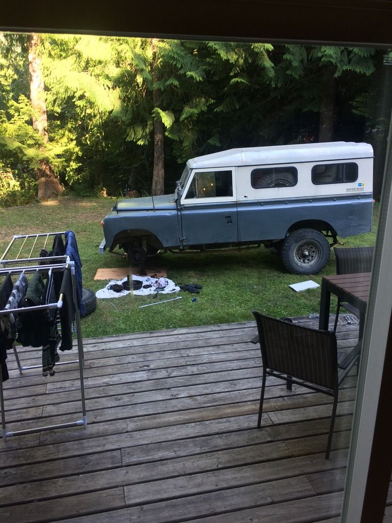

Yeah I guess I should add some background to that photo lol
I got the truck plated and insured about 6 weeks ago so have been driving it around the local area a fair amount, which has identified more bugs/wrinkles that need to be ironed out!

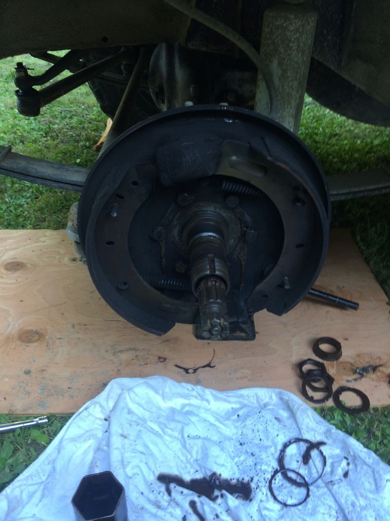

First up the hand brake was binding and locking up the wheels/transmission - fixed that use by slackening off the adjuster on the hand brake drum. After that little episode left me stranded on the side of the road (I always travel with at least vice grips now!) the front brakes started binding up... I bled the lines to relieve a bit of the pressure then slackened off the nuts on the master cylinder which worked for a while but I'm still binding slightly so will have to take a closer look at that. The front brakes are running quite hot so I haven't been driving it around much recently.... I'm not 100% convinced that my issues don't stem from poorly fitting brake shoes - remember a few pages back I had a really hard time getting the drums on over the shoes even with the adjusters backed all the way off... I hate dealing with taking shoes on and off but at some point I think I'm going to take off some of the metal where the shoes fits into the cylinder before I wear away all my lining!

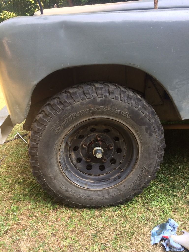

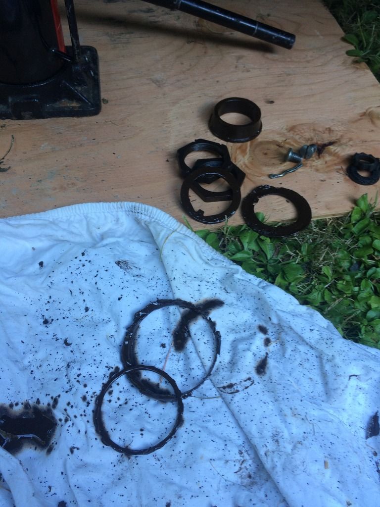

Oh and I discovered that my driver side front bearing had completely disintegrated (see pics below) after less than 500 miles since installing. I blame myself more than the parts though - between running the brakes/hub hot and having a lose drive member over the winter that leaked oil out/water in I think I compromised the bearing. Still, I was quite surprised by how quickly it failed!
Toasted bearing:
Lots of burnt brake dust!:
